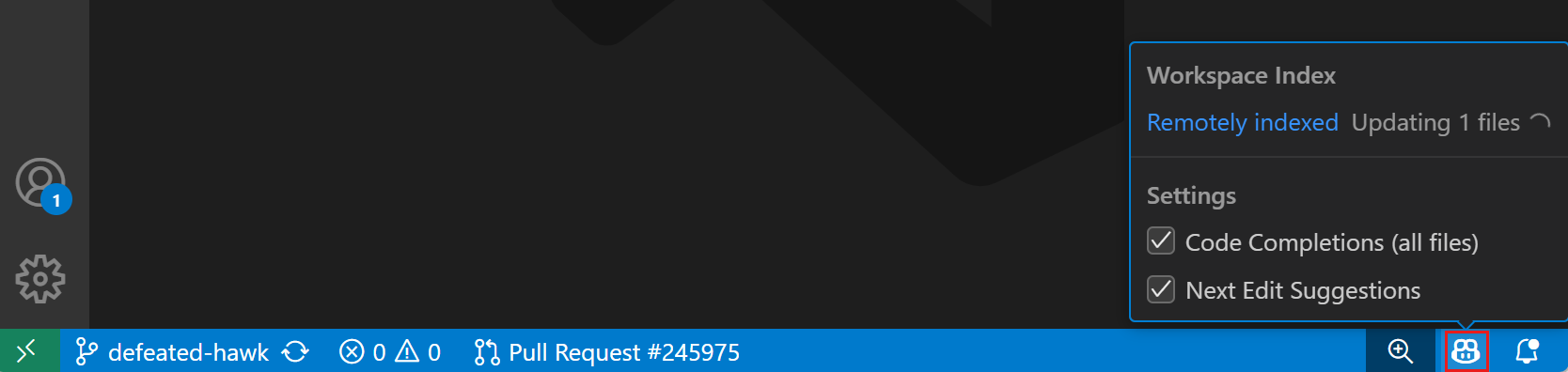

Managing the workspace index
Copilot uses an index to quickly and accurately search your codebase for relevant code snippets. This index can either be maintained by GitHub or stored locally on your machine.
You can view the type of index and its status in the Copilot status dashboard in the Status Bar.
Screenshot showing the workspace index status in the Copilot status menu.
Remote index
If your code is hosted in a GitHub repository, you can build a remote index with GitHub code search to enable AI to search your codebase quickly, even for large codebases.
